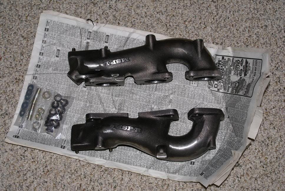

It started with purchase of these in 2007. I had to watch them go on sale knowing mine were still in the box:(,
MSP Manis

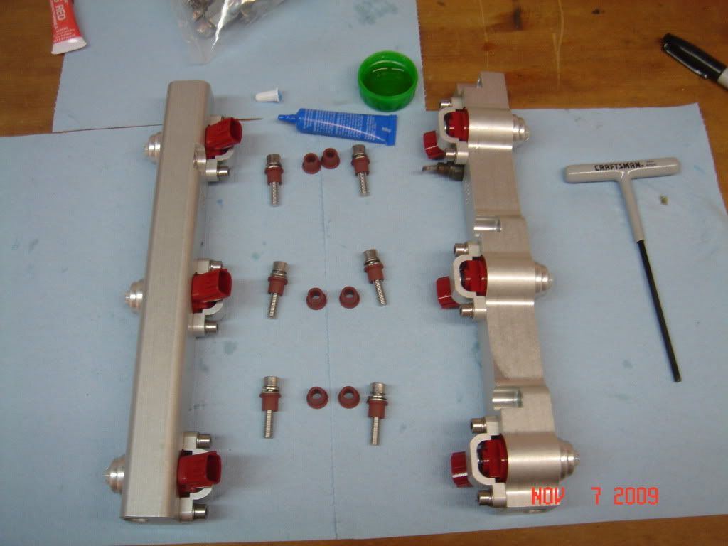

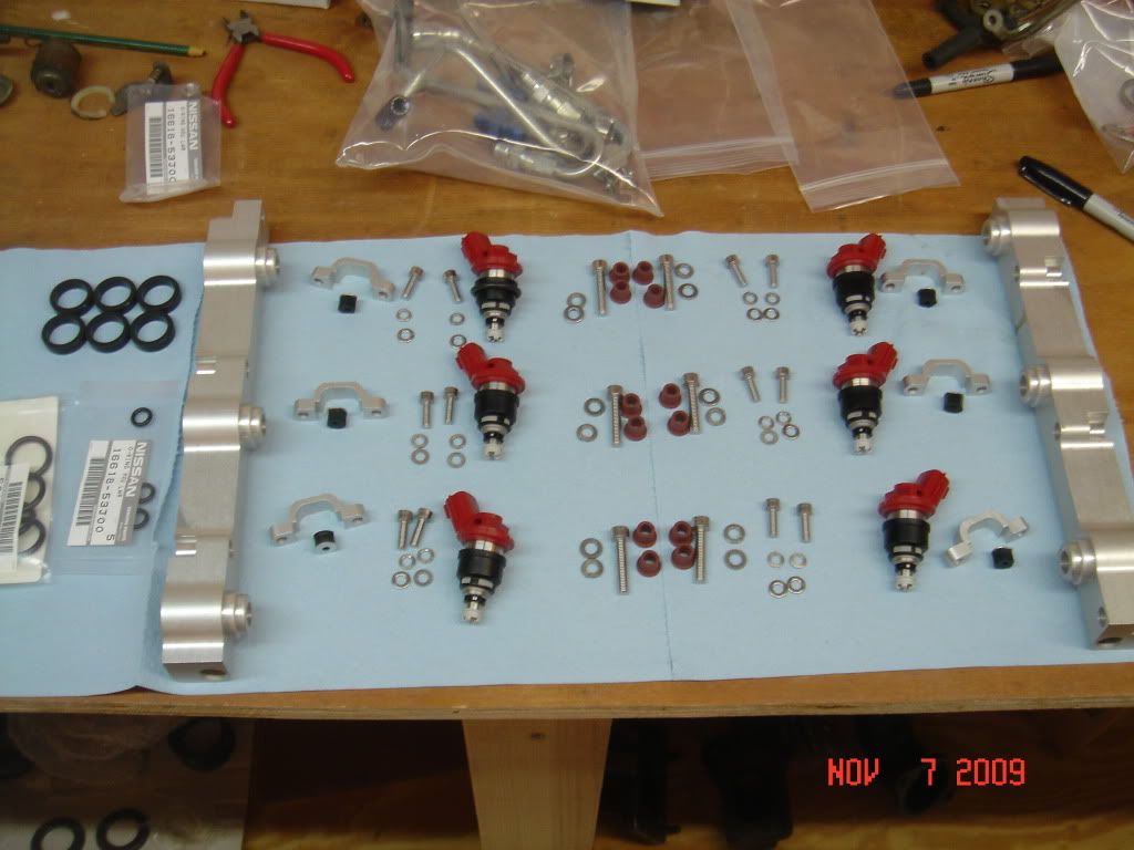

I also wanted to upgrade to new style injectors, so I got these (thanks Kyle).
FuelRailPcs
FuelRailComplete

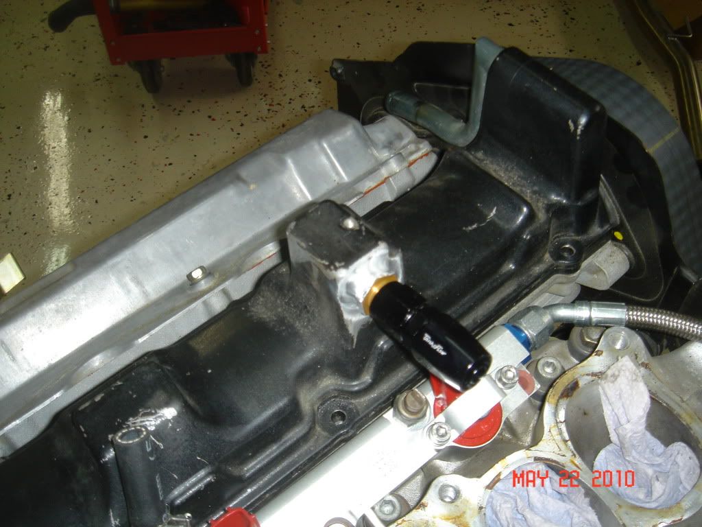

I also wanted to fix the smoke from PCV when I autocross although I haven't done that for several years now.
This was a small but big step for me as I wasn't comfortable with just screwing the AN fittings into the Cam covers.
So after much delay I found a welder to do this.
ANtoPCV
Also had more delay as I tried the freeze plug option here, but the were not a tight fit. Went with screw in.
PCVCap

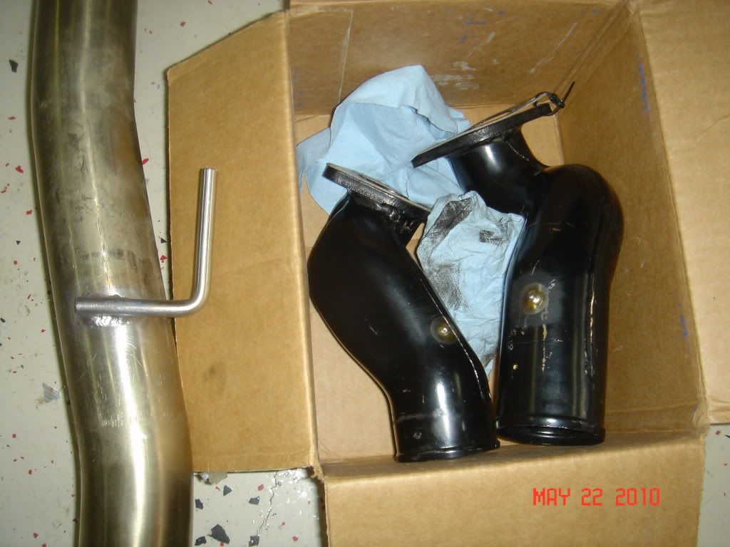

Since I found a good welder, I also had my SZ test pipe hanger repaired as it had snapped off.
One of the issues I setout to fix was vacuum leak. I had capped off the stock wastegate actuator ports, but the plug had split. So I had these welded also. I would love to get the MS Intake tubes here, but....

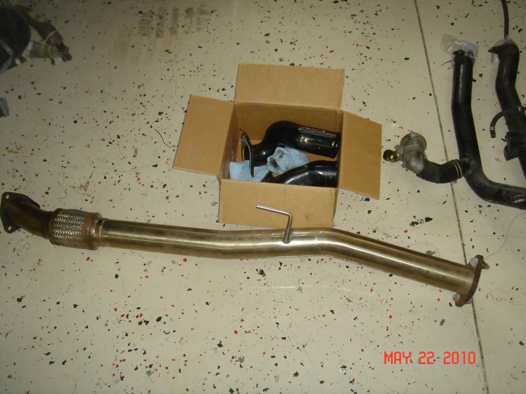

The Test pipes (2.5" with flex joint) will be in classifieds after I receive the 3" from Specialty Z.
Weldcloseup

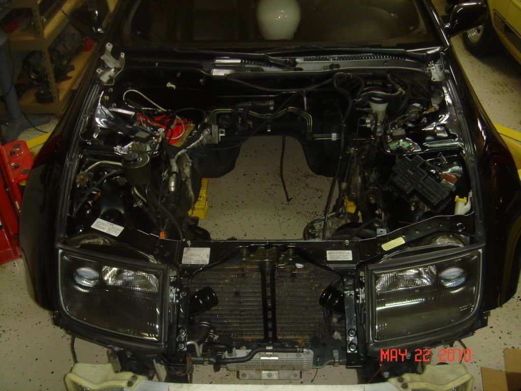

Here is the Z as it sets now. I just wonder if it will be back on the road before Collegeboy, Zfreak, RagtopZ or Madhatter.
EngRm
